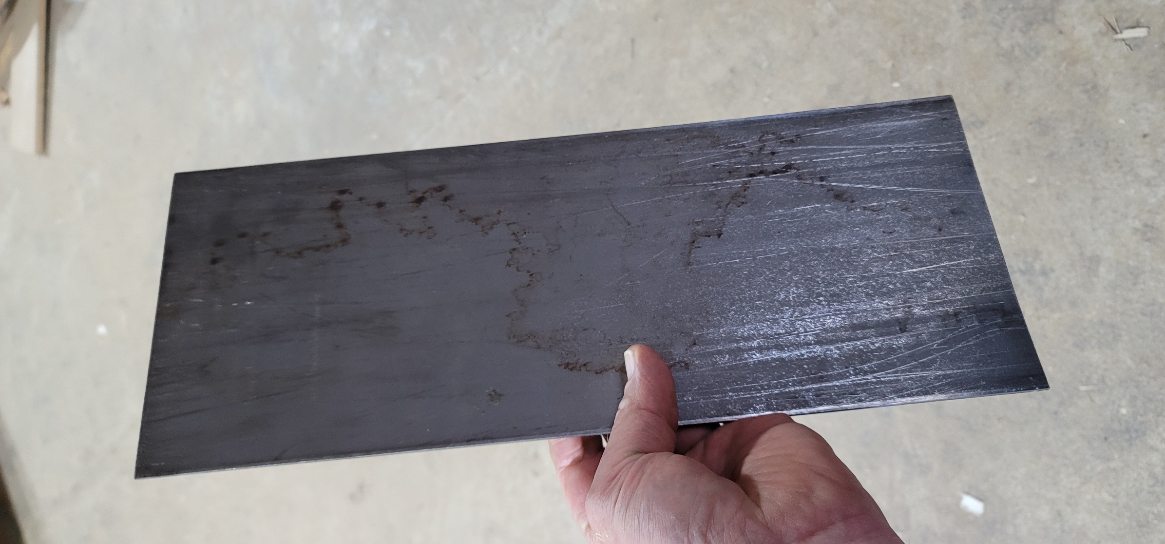

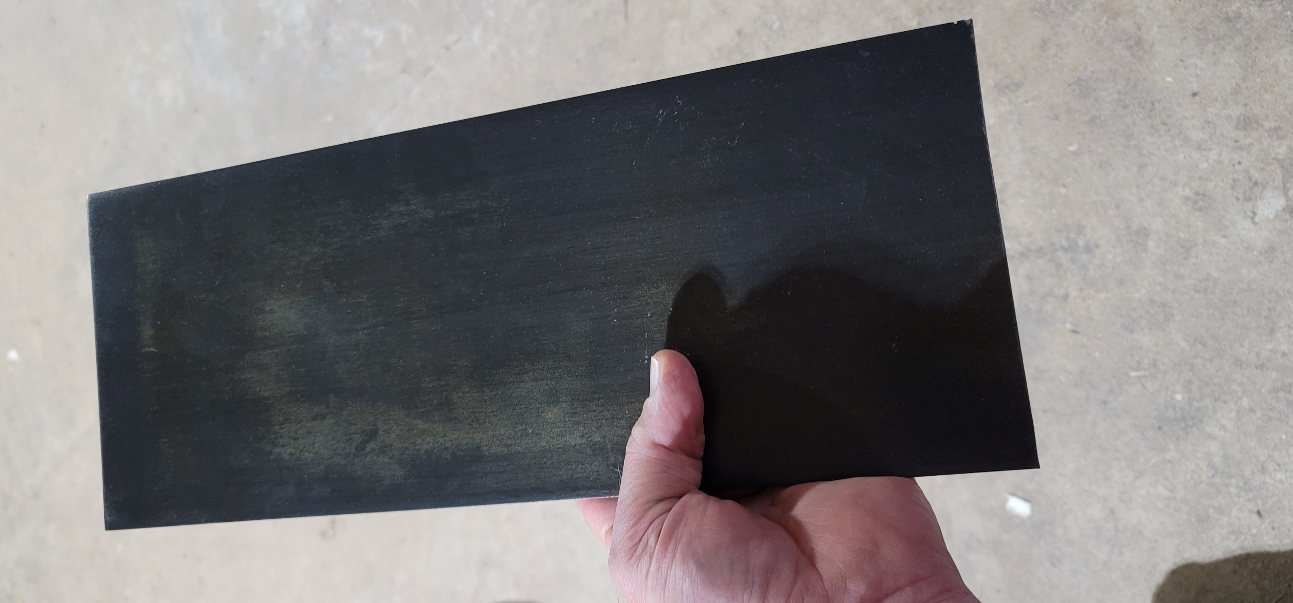

Running a bunch of furniture mix of wood and steel. Steel is getting a black acid patina (water based as well). Initial samples we just patina'd the steel, torch dried it thoroughly and shot a couple coats of waterborne CV to give it a sheen. I had thought there would be an issue with the waterborne over steel but weeks later the samples look great. We had initially planned on running solvent clear over the steel but most of the steel clears are just overpriced nitro so at this point were thinking of just staying with the waterborne. Have a call in to mfr. regarding anything long term that were missing but thought you all may have some input.

If there is any raw steel on the edges or corners, it will rust. I'd suggest a sealant layer of shellac before the water based top coat.

That was my concern as well from the onset. Sample shows zero after weeks of semi harsh treatment with zero backside coating so there are dead raw areas exposed to the coating.

Those are images of the same sample weeks old patina clear and raw back
