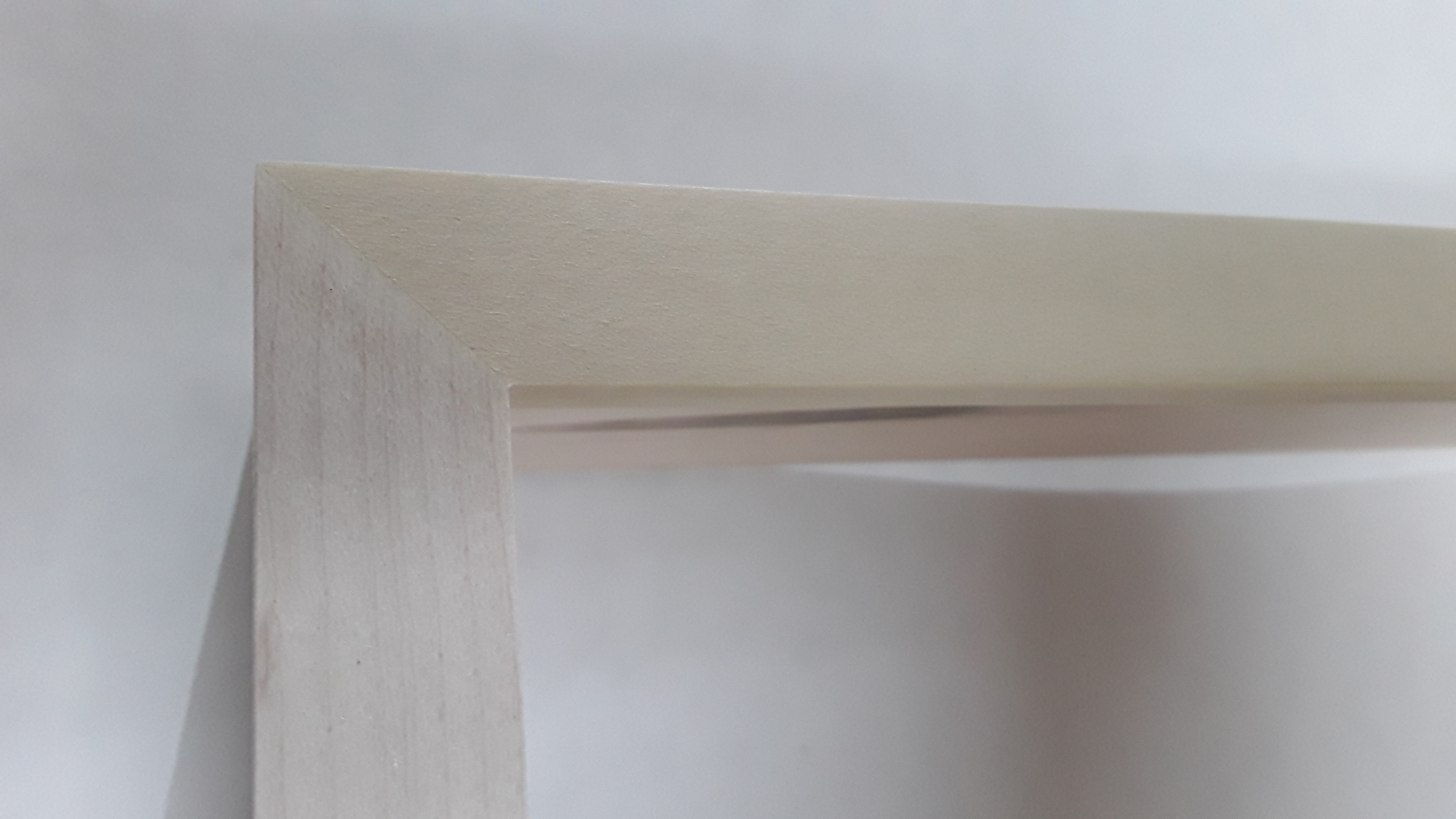

We have occasional issues with our 2 part bleach where raw maple is yellowing when bleached. The wood is freshly sanded and had no ambering any ideas on how to neutralize tannins or is it something else? Thanks
