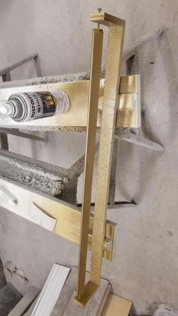

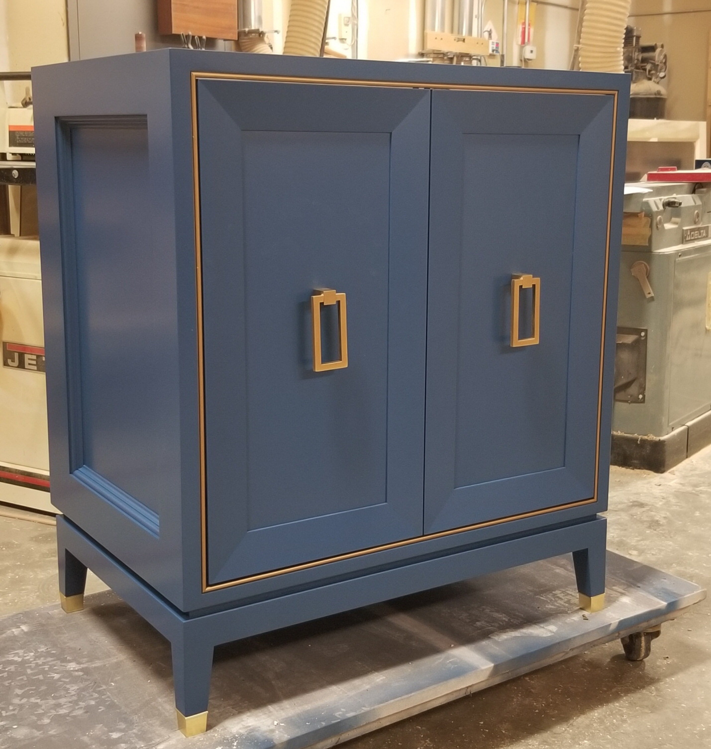

Leo G
Ya it was a spray can. Here's the vanity with the gold bead and I actually have a picture of the setup spraying the bead with a picture of the can in it. I guess the cap shows you what color it was and if you need to know that I might still have the can in the shop.
View higher quality, full size image (1429 X 1505)
View higher quality, full size image (576 X 1024)
