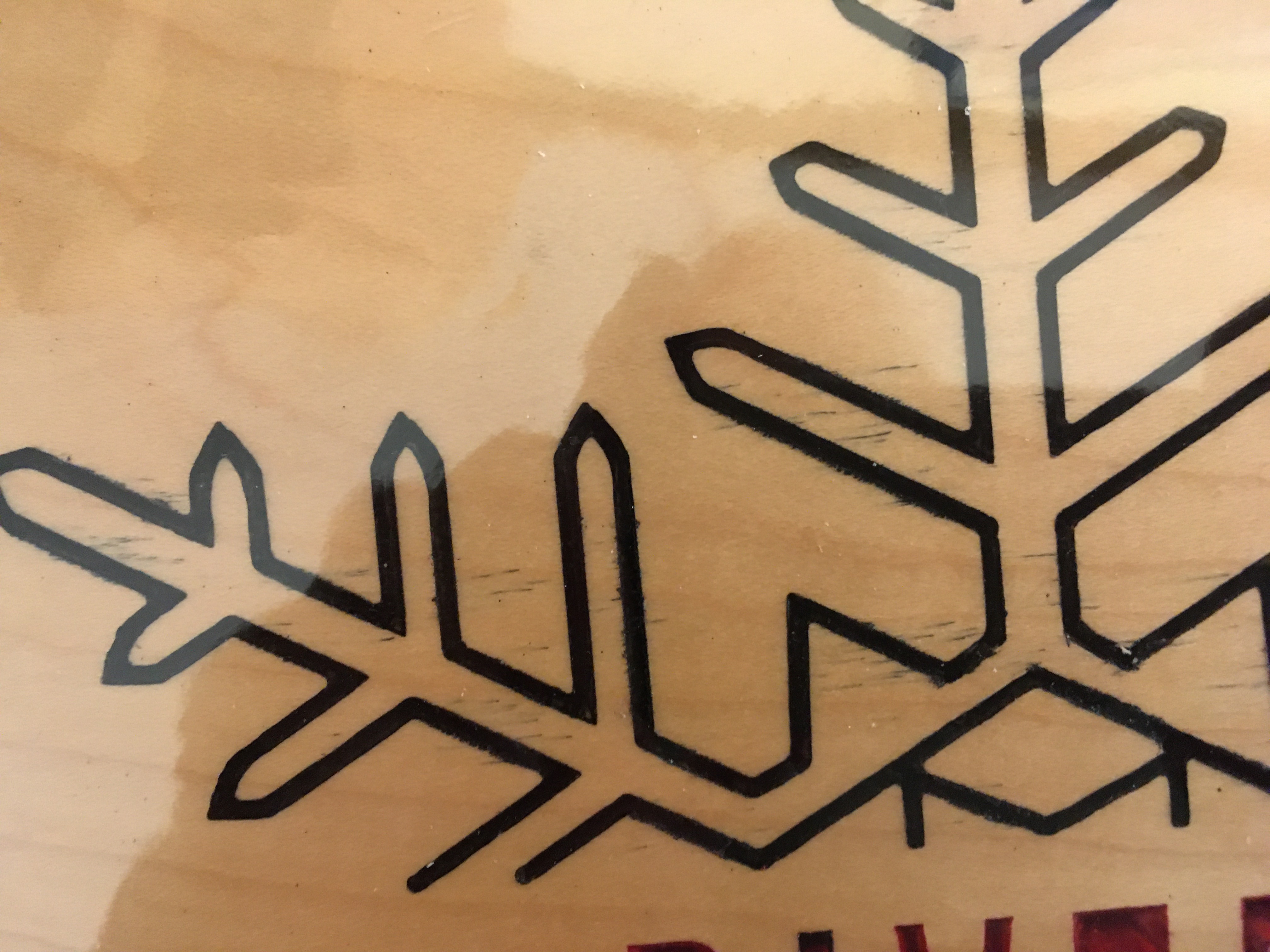

Hey all. Wonder if someone can give me a suggestion to resolve this minor problem.
I'm carving signs on the CNC with a 60° V-bit. The cut is about 1/16" wide x perhaps 3/32" deep. I'm cutting through a Oracal Oramask paint mask. All is going very well with the exception of some very fine thread like bleeding that is taking place through inner grain layers and up to the surface.
The material is pre-finished 1/2" maple plywood.
I carve the signs and then apply 2 coats of clear shellac into the V-groove carved lines. Without the shellac sealant the black paint creep through the grain and up under the pre-finished surface is severe. The 2 coats of shellac reduce it by about 90% but don't eliminate it. I've tried both brushed on shellac from the can and spray on from a rattle can. Both give similar results.
These bleed lines may emanate right from the edge of the cut or might jump 1/8" or so away from the carved cut and jump up to the surface out there. The only logical explanation is that the paint is finding fine pathways through the plywood core grain and coming up below the clear finished surface.
Finish paint is Krylon Fusion from rattle cans. That's a bit costly but there is adequate money in these repeat signs to justify the cost. The thinness of the paint is also a logical explanation of the bleed out occurring. I've found though that it is the best product for both speed and mask removal as latex paints can tend to peel out of the cut with mask removal on these tiny v-cut grooves. The idea was that the 2 coats of shellac would seal these grain pores and stop the bleed creep. I've thinned the shellac from the can about 10% and of course sprayed it directly as it comes out of the rattle can. It has helped a lot but not 100% resolved the issue.
As these are you have to look close to see the thread like creep lines so the signs are acceptable to the customer. I would like to resolve this completely though.
I will point out that one has to be careful on what paints to use on the Oramask. While Krylon Fusion colors work quite well (even though Oramask is spec'd for Acrylic paints) the Fusion clear finish will creep under the mask and cause separation. As such I really can't use that as vs. shellac. Surprisingly the Zinser clear shellac causes no problems here.
Any suggestions will be appreciated.

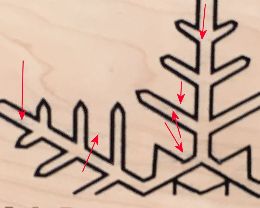

3/31/25       #3: Paint creep through internal grain ...
tom gardiner
The photo is a bit blurry to see the bleed but I know what you are talking about. I don't think you will ever get a full seal with shellac in the ply substrate. The cracks from the thick rotary veneer are just too big. I think you could change how you apply the black though. Still apply the shellac sealer but then try to spray a very dry coat of black. It is not easy with cans an air brush would be better. Many dry coats to get full colour.

BH Davis  Member
I came out to the shop the morning and got a better photo.
BH

Thanks Tom. Given your thoughts I'm trying one more thing with shellac this morning. I've rolled on 2 coats with a 4" roller, totally flooding the V-carved grooves right up to the top.
They're actually more like just under 1/8" wide by just over 1/8" deep, so the wells are able to hold a fair amount of shellac that then will hopefully soak back into the grain pores. This is from the gallon can and I'm rolling it at full viscosity.
I'll post the results later.
3/31/25       #6: Paint creep through internal grain ...
Pete
My only thought would be to not use the can shellac. Mix your own from de waxed flakes to get a thicker consistency. Might fill the pores/seal faster than flooding with the thin can stuff.
4/1/25       #7: Paint creep through internal grain ...
Use a black paint that is comprised more of pigments and not dyes. It's the dyes that are creeping into the grain pores.
Have you tried a black primer, then a black paint?
4/2/25       #8: Paint creep through internal grain ...
Do you think the paint might be getting between the prefinished film layer and the plywood? Maybe that finish is brittle or not bonded well?

I've completed the current group so this won't happen for several months now. The double coat of rolled on full strength shellac improved the situation dramatically but not 100%.
Thanks for the ideas everyone. This has been a strange problem.
4/2/25       #10: Paint creep through internal grain ...
Nick Sinderson
I've been finishing my local brewery's (Caldera Brewery Ashland Or.) wood tap handles for at least the last 10 years. At first we were using Ash cuts from Sawyer's oars until we needed more than they could provide so we started using Maple when the ash ran out.
The process we ran was;
Woodworker makes the handle
I finish with 3 coats of 2k WB poly
Then the engraver takes over; masking, laser engraving, painting black on the engraved surface.
On the first run with the maple the black paint looked to be weeping up under the masking but in reality one of the local wood turners pointed that the paint was being drawn up in tiny voids or straws that are present in maple. So we quit using the maple and went back to ash, problem solved.

I would try spraying a sanding sealer first. Or mist the black on with a primer first. You would need something that sprays better than a can to mist it. You could also try a water based, clear, grain filler. I also wonder if thinned down hide glue would seal the grain.

I doubt the maple is absorbing the color. It is most likely a poplar cross band below the maple that is absorbing it. Not knowing the plywood type, the poplar is a guess at best. With my suggestion on sealing it with hide glue- Id probably do a quick sample of mixing hide glue and then titebond, both thinned, on a flat surface, and see how well the paint sticks to both. I would lean toward using thinned hide over titebond but dont have a solid reason for that. I do think bw the glue, sanding sealer, or a thinned spray coat of primer, you will get it figured out.
