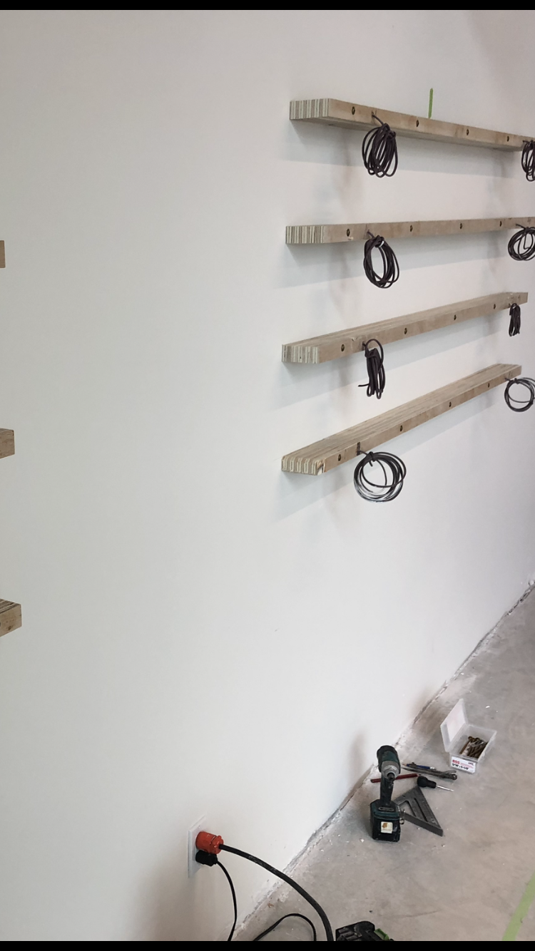

The trick is to get in early, install your own blocking or if heavy gauge studs you might be ok... We have used this stacked plywood method in the past, the backside of the shelf has a mating pocket, which is then glued and clamped in position until dry, makes for a solid install, the shelf can also be slid on multiple times for scribing, some systems make no allowance for fitting.
View higher quality, full size image (750 X 1334)
