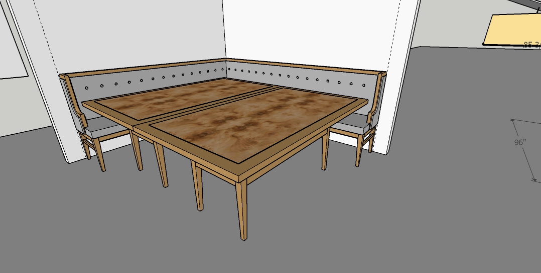

Preparing to build tables as shown in photos.
The tops are planned to be raw maple burl veneer over 2 layers of 3/4" MDF face glued together with a 4 to 5 inch wide solid white oak frame.
Am I good with just the raw maple veneer only, since the table top will be 1 1/2" thick with the heavy frame?
Or is it neccesary to apply another layer of veneer (Sapele?) either between the MDF sheets, or on the bottom of them?

I'd be more worried about any wide miters on the frame and that extreme overhang on the left table.
4/24/24       #13: Maple Burl Veneer Table Tops ...
Vince Member
Rich C-
Do you think butt joints would be better than miters for the white oak frame?
All overhangs are the same, must be optical illusion that one table has more. They wanted plenty of space for legs under tables.
