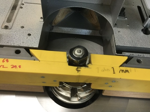

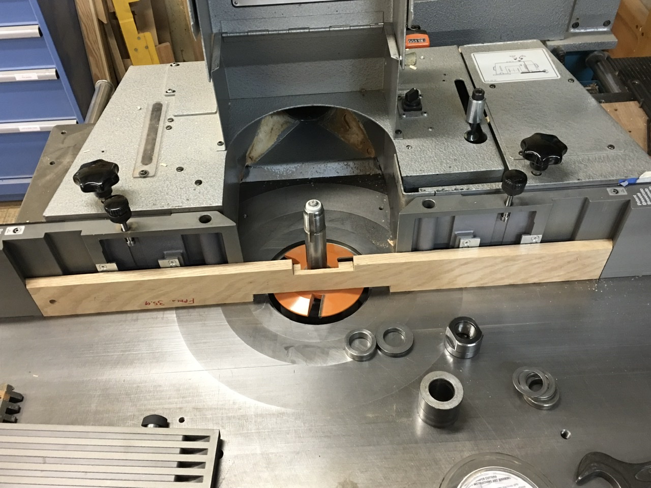

Zero clearance sub fences can close the opening between the fence halves when removing the entire edge of a frame. Especially helpful for narrow or small frames.
The pictures show one that is made to remove 1 mm from the edge same as using the split fences offset.
Mine are not totally zero. I usually just try to close the opening to 2 1/2 to 3”. Easy to make with motorized or handwheel controlled fences. Use caution with non pinned fences. Rough cut close with a jig saw.
The pictures with the yellow fence is using a 8” diameter cutter to outside profile 3” thick windows. The fence opening would be huge with the normal fence.
